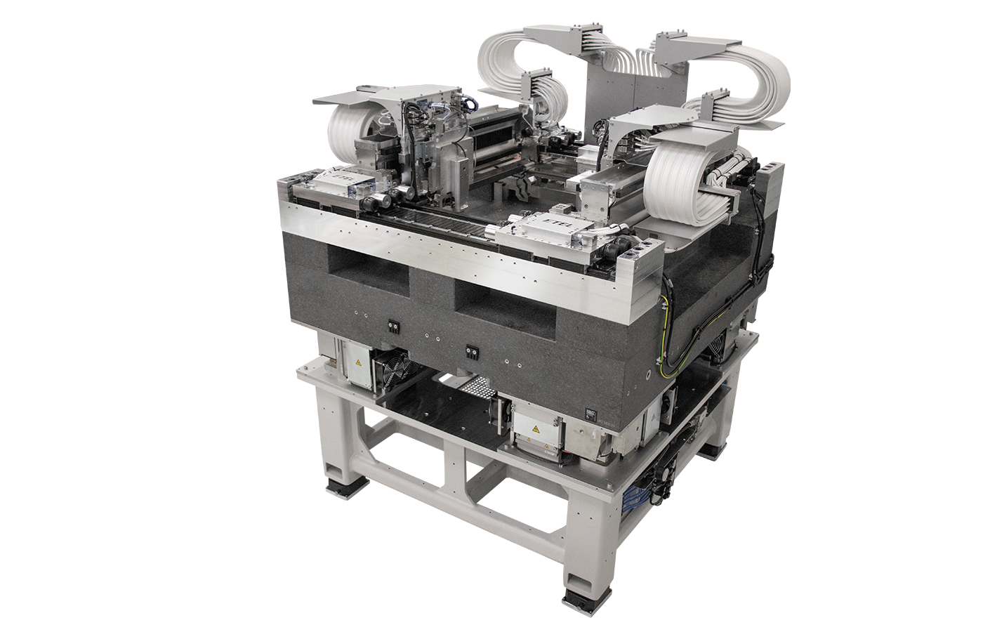

NEW: TELICA HP from ETEL
The gantry platform with unique dynamic performance and accuracy
5000 units per hour and
position stability better than 15 nm
The multi-axis TELICA platforms are specially designed for advanced packaging applications in back-end semiconductor processes, including hybrid bonding, thermocompression bonding, and fan-out applications. The latest generation of the TELICA HP is a fully integrated system featuring a dual gantry architecture, the QUIET active isolation system, the latest ACCURET control technology from ETEL, and MULTI-DOF linear encoders from HEIDENHAIN. At an output of 5000 units per hour, the TELICA HP exhibits accuracies of 1 µm or better, position stability better than 15 nm, and tool-center-point repeatability better than 50 nm over 25 mm.
Break the accuracy barrier with the TELICA HP, and benefit from HEIDENHAIN CORPORATE GROUP solutions that combine accuracy with dynamic performance, practical value, and reliability.

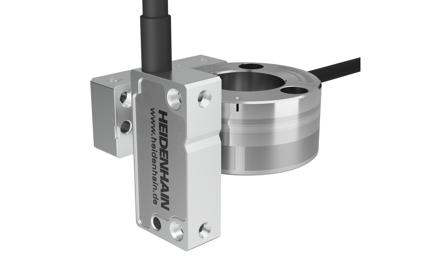

NEW: ERO 2900 Dplus
The modular angle encoder with linear feedback functionality
Compact, lightweight, and multidimensional
Discover an angle encoder that also delivers linear feedback: The ERO 2900 Dplus is introducing the multidimensional feedback of MULTI-DOF TECHNOLOGY to the world of angle encoders. In addition to its scale drum and scanning head, the ERO 2900 Dplus features a linear track read by an additional scanning head. As a result, the encoder measures not only the angular position of an axis but also its linear travel. This extra functionality is a decisive advantage in applications such as compact bond heads, where complex rotational and linear movements can be tracked with a single encoder alone.
